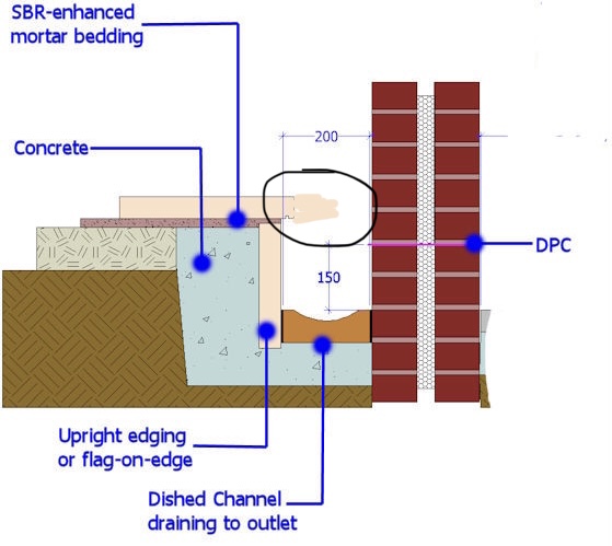

Hi guys and gals,
This is probably a pinned post somewhere by now but I’ve been trying to do a lot of reading this specific question. I’ve seen on https://www.pavingexpert.com/dpc01 that there are workarounds for this issue however I’m wondering if I do create a channel 150mm below DPC could I have the top flag sitting over the channel slightly to help reduce the gap to the door step.

Hi daniel408
This should be ok but only in the doorstep area.

stoneyboy wrote:Hi daniel408
Cheers bud.
