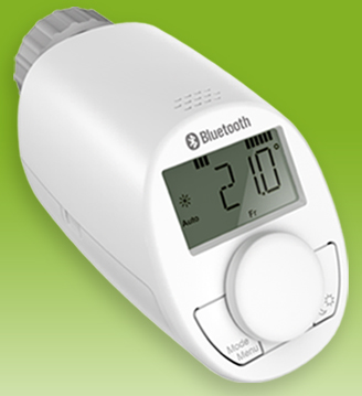

With a TRV marked *123456 normally half way between 2 and 3 will be around 20 degs C I have swapped my heads [attachment=0]61dmtMm13BL.jpg[/attachment] and I can set temperature in degs C and also the time, the advantage is the heads shown cost just £15 and they simply screw on instead of originals so easy to fit, and also easy to remove and refit old type when you go.
Not ideal would be better to get timer working, but even with boiler cycling when you are away, still likely cheaper than using electric to heat with. Mine called eQ-3 there is also Terrier i30 prices seem to have gone up since brexit, the eQ-3 I have is bluetooth so can adjust with phone, but so easy to adjust direct, I only use phone to set schedule, easier with phone but can be done without.
