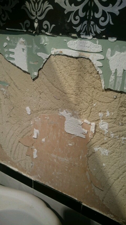

What do I need to do to this bathroom wall before I can start tiling? Thanks.

its best if you pva the wall first then plaster it to make it level

Straight pva or a mix with water? What ratio?
