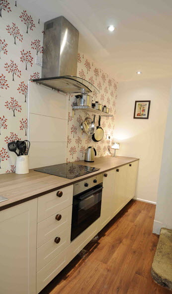

Far wall opens onto a tall enclosed courtyard with 3 steps descending to it. Wall on far left I THINK is earth backed. At extreme left of image is stairs leading upto livingroom. Wall to right is described in other image.
Far wall is backed to earth (historically had water ingress or damp). Wall with cooker has external stairs leading from road above (I think there was a slight moisture/damp/ingress issue here also). Visible at far extreme right of image is the old coal store. Bottom of stairs to living room visible.
