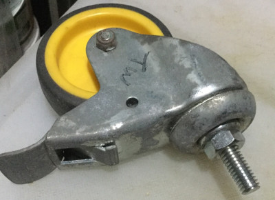

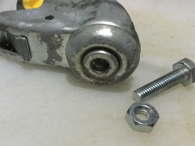

Get the kind of casters that have a hole in them, drill a hole in the bed legs that are a little smaller in diameter than the bolt, chisel out a recess for the nut, sink the nuts into the legs (you can use epoxy if you want but if the bolts are long enough and the sockets for the nuts are a good press fit epoxy isn't necessary).
Then just let the bolts cut threads into the wood.
Depending on the hardness of the woodyou will need a minimum of 40mm of thread into the wood, the softer the wood the more thread you will need in the legs.

Thanks very much for taking the time to send such an informative reply. I also posted on another forum where someone suggested using Teflon furniture glides, which, he said, allow easier movement than castors, so I'm going to check those out. Apart from anything else, they'd save me a lot of work and I'm not a great DIYer anyway. But if they turn out not to be suitable, the method you suggest sounds like the way to go. I had been concerned that the headboard feet, being only 33mm wide, wouldn't be able to take the sleeve for the bolt, but with just using the bolt to cut its own thread I think the 33mm feet would take it. The only part of your reply that I wasn't clear about was where you said "chisel out a recess for the nut". Do you mean to chisel out a hole around the hole, if you know what I mean, this hole being a snug fit for the nut and shallow enough so that the face of the nut is flush with the bottom of the foot? If so, I suppose the hole would have to be hexagonal, so I'm wondering how easy or difficult would it be to chisel out such a hole. As I said before, I'm not great at DIY, so apologies for the dumb questions! Thanks again.

That is it.
Put a couple of nuts on the bolt, drill the first part 5~10mm of the hole slightly larger than the bolt. Put it in the hole then give a couple of wacks with a Birmingham screwdriver and you may not need to use a chisel.
