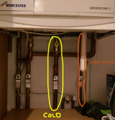

This has been bugging me for a couple of weeks now but then I thought... could it be possible that these 3 rads are on a different pipe all together? separate from the others - and possibly turned off? Is this normal for a 3 storey house to have separate flow/return pipes for certain parts of the house? Now that i think of it, all the ones that aren't working are vertically aligned (ie. facing the street window).
Also, went back down to the combi boiler and found out that the middle pipe is dead cold whereas the others are hot...Could this be the reason?
Attached picture of it...
Any ideas/help would be appreciated!!!

I would expect the pipe you've highlighted to be cold - It's the gas supply.
It's quite possible that the system could be zoned, especially as it's 3 story. If so, there should be obvious controls. Again what happens if you turn off the other radiators, just leaving the cold ones on ?
