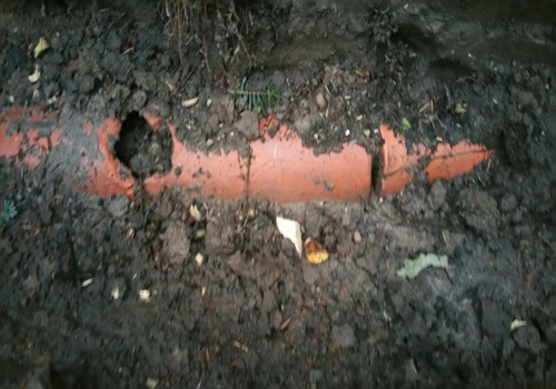

Remove or Repair Pipe With Hole in
Handybrit
Joined: Wed Sep 27, 2017 11:59 am
by Handybrit » Wed Sep 27, 2017 12:20 pm
replace it, the weight of the soil on top of a repair may crack the pipe and worse case is it collapses
cut it back or go back to the nearest join but you may end up replacing the whole run
edit. You need to find where it comes and goes to, if it is a post 1936 home the drains should be mapped
