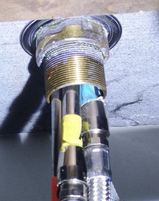

Hi, I'm trying to remove a Franke Belfast kitchen tap and it looks like it needs a special tool? Can anyone confirm this or am I just being useless

You will need to undo the "nut" using grips but first use a wire brush on the exposed threads then spray the penetrating oil or similar. You will need an assistant to hold the tap itself.
