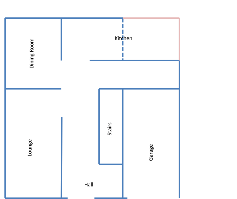

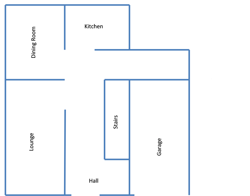

My 1930's house was originally L-shaped:
At some point, someone added a single-level extension to the kitchen:
The dotted line represents where a load-bearing wall has been removed and replaced by an RSJ.
I was wondering if it would be possible to remove another load-bearing wall to increase the kitchen further:
The dotted lines represent RSJs. Would this be possible without putting in a column?
Thanks,
Carl

befre you do anything do you really want a pillar in the middle of your kitchen
and end up with a shudda wudda cudda ******* right before you start
you shoild download IG lintles price list they do box100 lintles up to 4000mm
no need for structural engineers they are made for the spans at about 700£ each
they have to be installed as a pair bolted together with spacing
so they support the full width of the wall the end bearings are the same as norm
