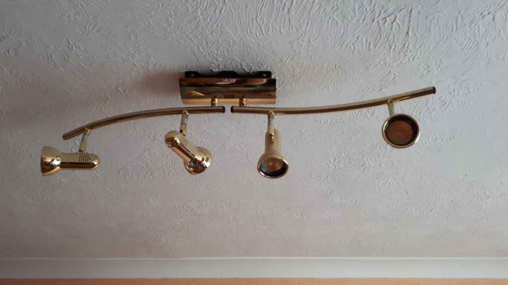

I have had this light fixture for many years and it has just completely failed. When switched on I can hear a faint clicking noise from inside but no light. I suspect there maybe a transformer inside that has failed. The bulb fixtures state Max 35w 12v MR16. Is there any way of repairing this or modifying to take modern mains voltage LED bulbs?
[attachment=0]20191204_130542.jpg[/attachment]

It will not have a transformer as such but it will have a switched mode power supply, since the lamps do not illuminate and you can hear a clicking noise it is safe to assume that the switched mode power supply has failed and needs replacing.
You should replace it like for like.
