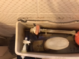

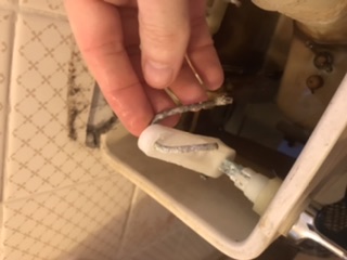

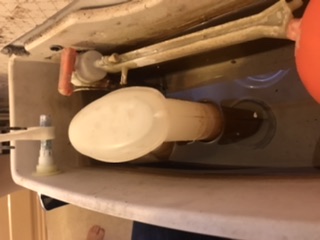

Today, the link which attaches The handle part of the toilet flush system to the rest of it snapped due to what looks like age/corrosion. Looking to see if I can to replace the internals of the toilet cistern myself but confused with what specific kit to buy as toilet about 30 years old. See pics.
Any help/advice would be appreciated - went to the likes of wickes and b&q today but wasn’t 100% certain what Kit suited and Didn’t really have the knowledge or any pics to explain what I was after.

If the flush used to work ok just buy a new link - the metal rod which is bent like an S - and fit this.
