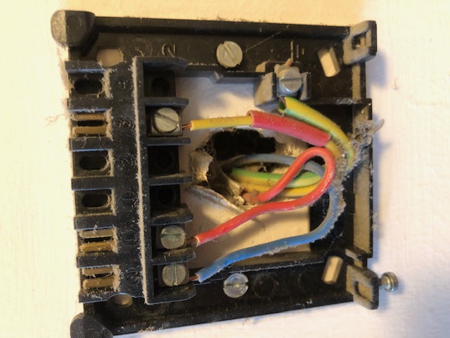

I am trying to replace a DRAYTON standard Thermostat with a Programmable Honeywell T3 or T4 or similar. The new ones all seem to be battery powered The current one has the following connections N - Blue, Live - Red, 3 - a yellow wire sleeved red and an obvious earth.
The honeywell has a A B C With I believe the A being the equivalent of the 3. I believe it shows the Live (Sleeved red) going to the A and the other Live (Real RED) going to the B. Am I right in thinking that the Live (Sleeved red) should go to the A and the other Real red should go to the B. I believe I should then seal off the Blue. I don't want to blow the device on fitting. Thanks for reading this far!
Any ideas Please

For most programmable thermostat you will only need the red and yellow wires, as you say battery powered so does not need neutral. But with any wireless thermostat (Except Nest e) you will need the neutral, so need to put unused wires safe so in the future you can use them.
I fitted the Flomasta 22199SX Wired Digital Programmable Thermostat (Screwfix number 6259G) which has worked well in last home, with a wired thermostat no need for expensive types, but with wireless the cheaper ones don't fail safe, i.e. if battery goes flat central heating defaults off.
