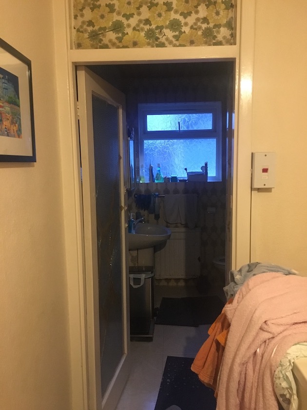

Our bathroom door needs to be replaced as the glass has smashed (please see the attached image). I measured the existing door and the dimensions are 1890 x 695 x 30.
I have looked for a new door. However, it seems that the measurements are not standard. Could somebody recommend a place that makes made to measure doors?

Rather than getting a door made you may find a standard 2’ 3” door is close enough. You could always add a thin strip down the frame but don’t forget the glass must be safety glass.
