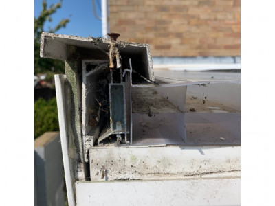

Recently moved into house, the conservatory roof looks old but not too sure how old exactly.
Looking to get replacement polycarbonate panels like the one in the picture but unable to find similar ones (the edge goes up)
Anybody know where to buy old style panels or if its best to put in the new style ones which i think will require some wooden beams to be put in place.
TIA
Panel inserted into glazing bar
Underneath join
Underneath join

by stoneyboy » Thu Sep 17, 2020 9:56 pm
Hi timeldridge
I don't think the panels you have are made any more so you will have to replace them with thinner sheets and suggest you use purpose made glazing bars.
