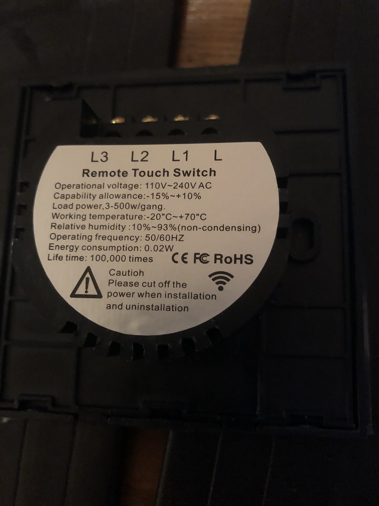

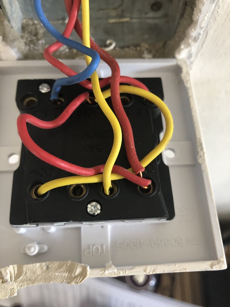

Similar wiring problem. See the image
. its a 3-gang front plate. Planning on replacing it with a touch switch on the 433 MHz spectrum to link in to my home automation system. New Switch has 4 connectors labelled L, L1, L2, L3 (
). Help on how to convert would be appreciated.
Best regards
Rob

On the old switch, you have a feed wire going in to the first one.(the one with 2 reds in) then going into the second & then a yellow one into the third(should have had red sleeve on) get rid of the short yellow & red ones, all these are live feeds in.
now, the feed red cable that I mentioned above is to go into L.
the other three cables are to go into L1,L2,L3.
that's basically it, you may have to swap cables L1,L2,L3 around a bit to get the correct switching order.
If you look at the old switch, break it down into 3 parts, each with one terminal at the top & 2 at the bottom.
