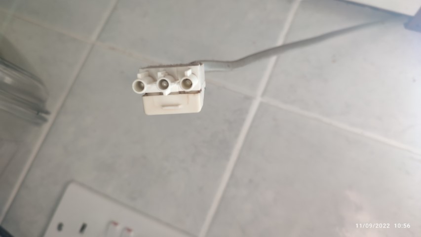

I am looking to replace two current fluorescent undercabinet lighting units with LED equivalents.
The current lights are daisy chained together and I attach a pic of the plug at each cable end of the linked unit.
The new LEDs have a Figure 8 connection but I have been unable to establish the identity of the existing plugs in order to purchase suitable converters.
Are they available at all?
Posts: 1343
Re: Replacing undercabinet strip lights
by Mr White » Sun Sep 11, 2022 12:55 pm
In the time you will take to find such "converters" (If they indeed exist) you could have either changed the existing plugs or installed new cables as required and saved time / money in the process.
Posts: 2871
by ericmark » Tue Sep 20, 2022 11:40 am
If the original connector is ISO then you may find [url=https://www.tlc-direct.co.uk/Products/GKLC20.html?source=adwords&ad_position=&ad_id=&placement=&kw=&network=x&matchtype=&ad_type=pla&product_id=GKLC20&product_partition_id=&campaign=shopping_accessories&version=finalurl_v3&gclid=CjwKCAjwyaWZBhBGEiwACslQo36xHXvb_f8VopeVOJh6Qt4jpeF5BPZDc8KuCn9BHtquMXuDCEaLGBoC35QQAvD_BwE] an adaptor [/url] but in the main we use a junction box, and cut off the original connector.
