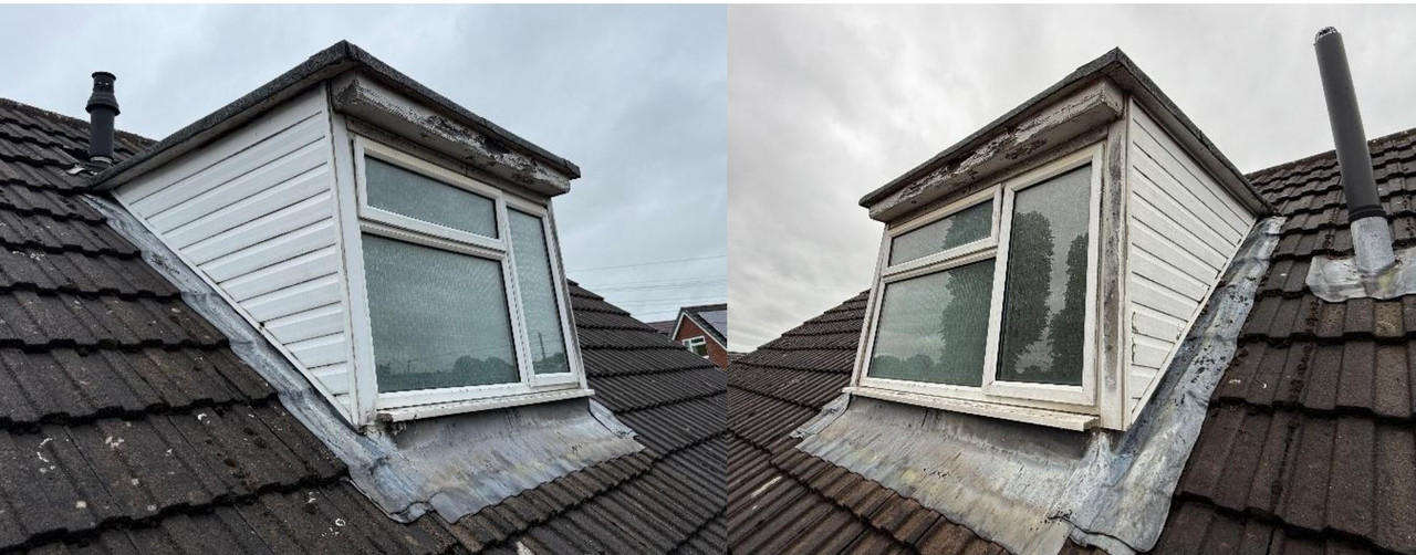

I’m in the process of buying a 1970s dormer bungalow and the survey has raised a few roof-related points. I’ve attached the relevant photos and would appreciate opinions on how serious these issues look and what work may actually be needed.

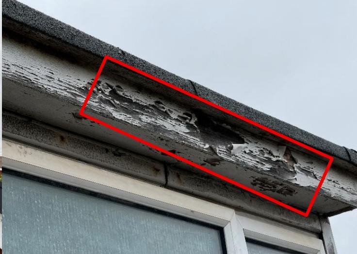

1. Timber fascia/soffit above the dormer
Most of the main roof fascia and soffits are uPVC and were described as serviceable, but there is a short timber section above the dormer window. The paint is badly flaking and the timber looks heavily weathered. The surveyor said there was no obvious structural decay and recommended preparation and repainting. Does this look like something that can realistically be stripped, repaired and repainted, or is replacing that timber section likely to be more sensible? I’m also wondering whether the roof-edge or felt detail above it could be causing the repeated weathering.

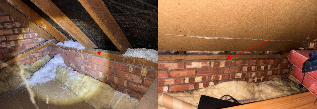

2. Slight wall plate movement
In the loft, the surveyor noted slight movement and localised lifting of the timber wall plates where they are bedded onto mortar. They said the movement is minor and there are no signs of immediate structural distress, but recommended fitting galvanised restraint or holding-down straps as a preventative measure. From the photos, does this look unusual for a roof of this age? Would you ask a structural engineer to specify the straps, or is this normally straightforward work for an experienced roofer or builder?

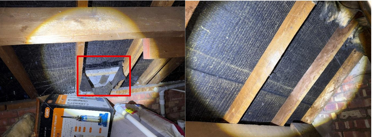

3. Local damage to roofing felt
There is a damaged section of the older black roofing felt in one part of the loft. The surveyor described the rest of the visible felt as generally serviceable and suggested a simple patch repair. Can this be repaired properly from inside the loft, or should the tiles be lifted so the new patch can be lapped correctly from above?

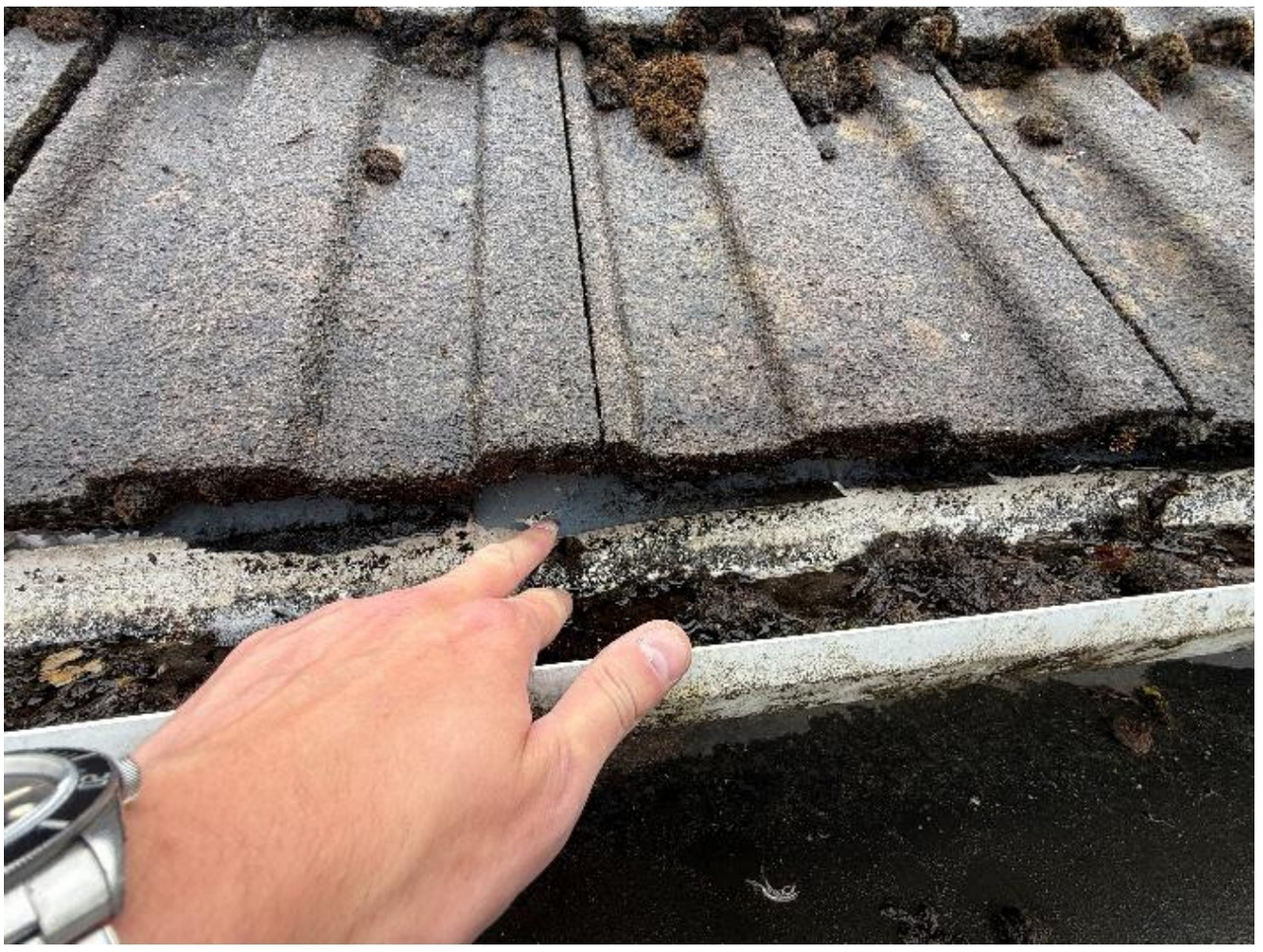

4. Plastic tray or membrane at the eaves
A plastic strip or tray is visible beneath the bottom row of tiles at gutter level. The surveyor thought it may have been installed as a previous repair where the original felt had deteriorated at the eaves. There were no signs of active water penetration internally, but the detail was mostly concealed. Does this look like a normal proprietary eaves support tray, or an improvised repair? Would lifting a few of the lower tiles be the best way to check that the original felt overlaps the tray and that it discharges correctly into the gutter?

1. Possible cause is condensation in the dormer flat roof structure, may be advisable to fit vents.
2. Wall plate lifting may be caused by birds mouths in rafter have not been cut deep enough - no solution
3. Felt Damage can be repaired from within - make sure old felt is on top of the new felt at the top and below the new felt at the bottom.
4. Plastic strip below lower tile line protects the facia but it needs to be under the old felt up to the first batten.

1. What in the photos makes you think the dormer fascia deterioration could be caused by condensation rather than rainwater getting onto the timber externally? Would you expect to see staining or dampness inside the dormer roof structure? Also, what type and position of vents would normally be used?
2. Regarding the birdsmouth cuts, is there anything visible in the loft photos that suggests they are too shallow, or would the rafter feet need to be exposed more before this can be confirmed? When you say “no solution”, do you mean it is not worth altering if the roof is otherwise stable, or that it cannot be corrected?
There has also been a comment about the roof-spread restraint and whether the rafters are properly tied to the ceiling/floor joists. Would the birdsmouth issue be separate from that?
3. For the felt repair from inside, would you normally loosen or remove any battens to get a proper overlap, or can a new section usually be fed into position from the loft? I want to avoid someone simply taping a patch over the underside.
4. For the plastic eaves tray, am I right that the existing felt should overlap onto the top of the tray, and the tray should then discharge directly into the gutter? Would lifting the first row of tiles be the normal way to confirm it has been installed correctly?
