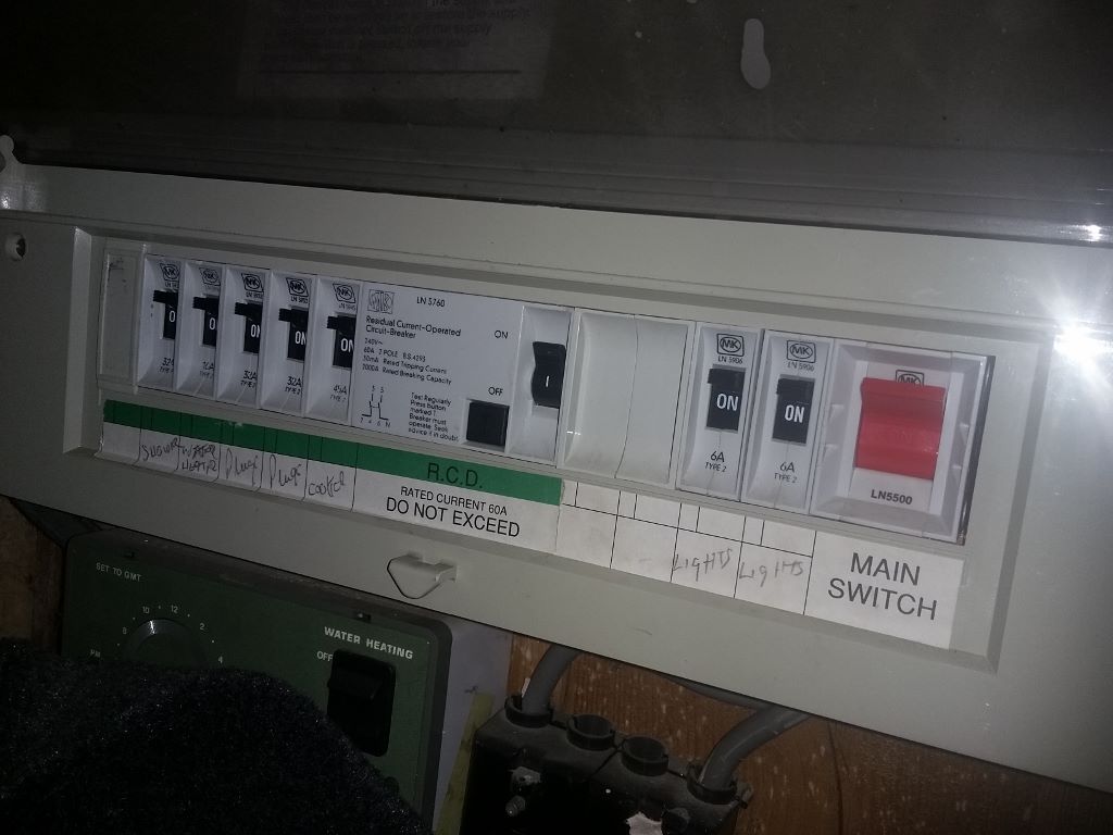

hello i`m replacing a shower for my brother
the old one was a 8.5kw running on a 6mm cable and protected by a 32amp
just opened new shower Triton 8.5kw
added photo of consumer box and booklet
on my brothers consumer box it states do not exceed 60A
in the booklet paragraph 4.1
if its below 80A please read 4.1
and yet i took out a 8.5kw shower it has a 6mm cable protected by a 32 fuse
been working for years !!!!!
thank you Paul

Hi Paul,
The 60 amp on the fuse box is purely for that RCD (bigger fuse that looks after all the smaller ones underneath it). It basically means if all those smaller fuses together pull more than 60 amps, then the RCD will trip and stop the power to them all.
The lights (from what I can) on the right by the main switch, are not protected by an RCD but that's another story.
The shower will be fine

The 60 amp on the fuse box is purely for that RCD (bigger fuse that looks after all the smaller ones underneath it). It basically means if all those smaller fuses together pull more than 60 amps, then the RCD will trip and stop the power to them all. [/quote]Sorry no that is not what in the main would happen, you can get RCBO's where the device is both an overload and a RCD trip, but the one shown is simply a RCD, it will have three ratings 30 mA refers to the maximum leakage before it trips, so should trip between 15 mA and 30 mA the 60 amp refers to the maximum current it can handle without damaging the device, it will not trip at that current, there will also be a prospective short circuit current maximum this is matched to the loop impedance of the supply or let through valve of the main DNO fuse and is what the device can handle without danger although it could cause damage. [quote="Scottv3"]

paultoolbox
Get in an electrician to test and inspect the work for you.

opened the consumer box to run 10mm cable
the last sparky got his fuses mixed up !!!!
i put the shower off it was still LIVE
he wrote shower but in fact it was the cooker on a 32amp
so the shower now has a 45amp and a 10mm cable
thank you paul
