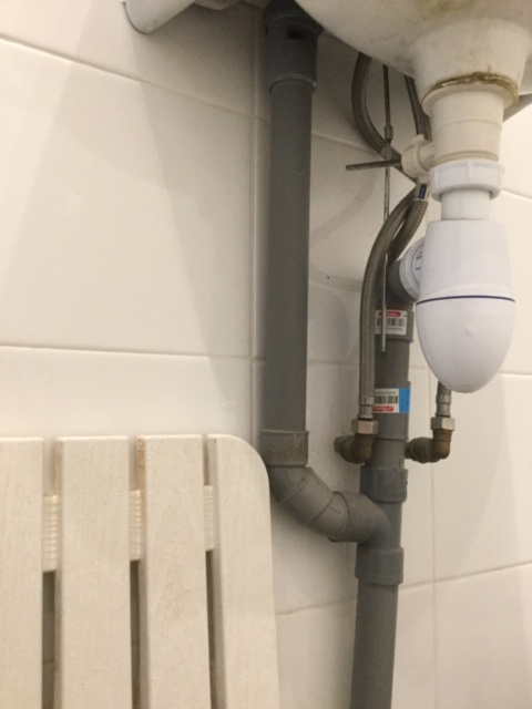

haoconn
Posts: 6
Joined: Fri Jul 20, 2012 4:08 pm
Re: Shower Water Trap Problem - Anti Vac?
by haoconn » Sun Nov 24, 2019 1:52 pm
Hi Michal,
Re your question, we fitted 3 valves to the 2 bathroom sinks and the kitchen sink. Please see pic.
Good luck, Anthony
ebauu
Joined: Sat Nov 23, 2019 12:52 am
by ebauu » Mon Nov 25, 2019 12:48 am
Thanks, my plumber has also advised to place the valves under the sinks, but I was concerned if that would fix the shower smell. Meaning if those sinks valves would help release vacuum from the shower traps. From your answer it seems it could work. Thank you so much!
