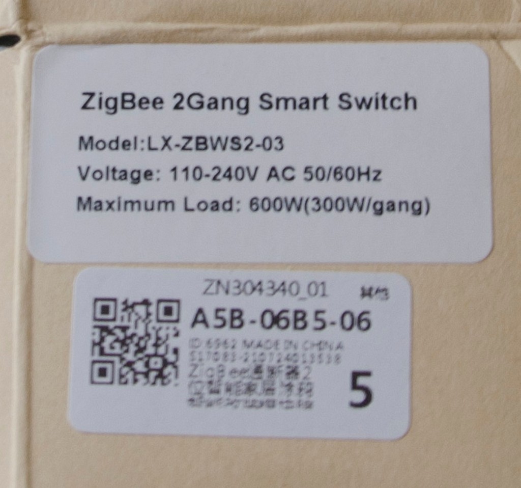

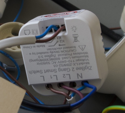

I wanted to control the landing light, combination of original switches and smart controls, and I found this [attachment=1]DSC_6061.jpg[/attachment]
It fits inside my light turns the light switch to extra low voltage and tests seem good, but need ladders to fit it so sitting in a box for son to fit for me.
More details here [attachment=0]DSC_6060.jpg[/attachment]
Things move on, since I first replied to this post, had Smart switches and sockets fail, and with some thing hard wired that means power off to replace, where smart bulbs you don't need to turn off all lights to replace one bulb.
