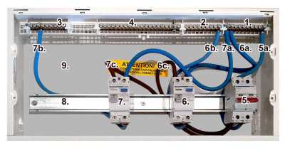

[img]https://www.consumerunitworld.co.uk/ekmps/shops/consumer/resources/Design/inside-high-integrity-consumer-unit.jpg[/img]I hope the picture works, it shows 1/2/3 : (Three) Neutral Bars - the defining feature of a High Integrity Consumer Unit 4: Earth Bar.
The RCD works by comparing supply and return, if the same it will not trip, other wise it trips, likely you have selected wrong neutral bar, or if using RCBO's wrong trip for neutral.

[attachment=0]inside-high-integrity-consumer-unit.jpg[/attachment]May be this will work better? it shows 1/2/3 : (Three) Neutral Bars - the defining feature of a High Integrity Consumer Unit 4: Earth Bar.
Wrong neutral bar and it will trip.

Ericmark - you were absolutely right. I wasn't even aware that there were different Neutral banks on a CU. anyway the problem is now sorted and everything is working as it I intended it should. Thanks again.
