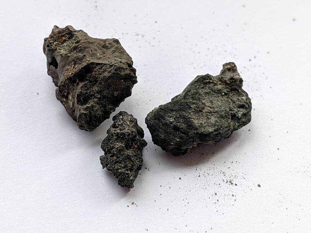

We're buying a house (built in 1938, Shrewsbury) which has an active woodworm infestation. We were planning to spray the floorboards that currently exist with pesticide. However, when we pulled the boards up on the ground floor, the subfloor was unusual. There are 3 rooms that need treating, the hallway, living room and dining room. Under the Livingroom and Dining room, it looks like concrete has been set in-between the joists with about an inch gap between the concrete and the top of the joists that suspend the floorboards. When we pulled up the board in the Hallway, it was almost resting on a substance that we believe might be ash or shale (it was mostly grey-black, I've included a picture of some pieces we took from underneath the board). We had originally intended to keep the floorboards, but since they are tongue and groove and we cannot spray under the subfloor there will be considerable damage done to the floorboards if we plan to pull up every board in order to treat them with insecticide.
substance under hallway floorboards

    We're speculating that the ash/Shale substance in the hallway should definitely be removed as it could be concrete that has sulphur damage if this is the case, does this mean we should we rip up the concrete in the other rooms too?
