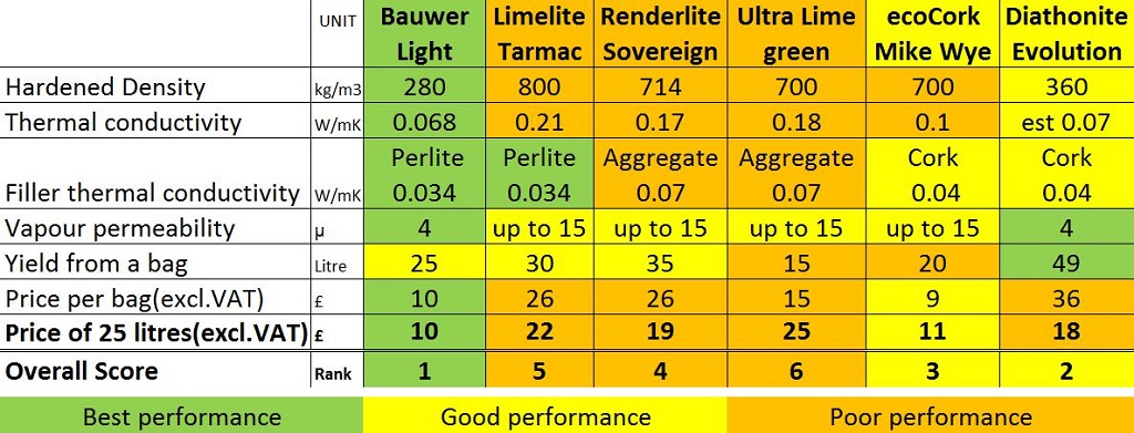

My suggestion would be removing all impermeable materials, like sand cement render and replacing with highly permeable materials.
Regards, Alexander
