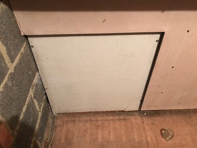

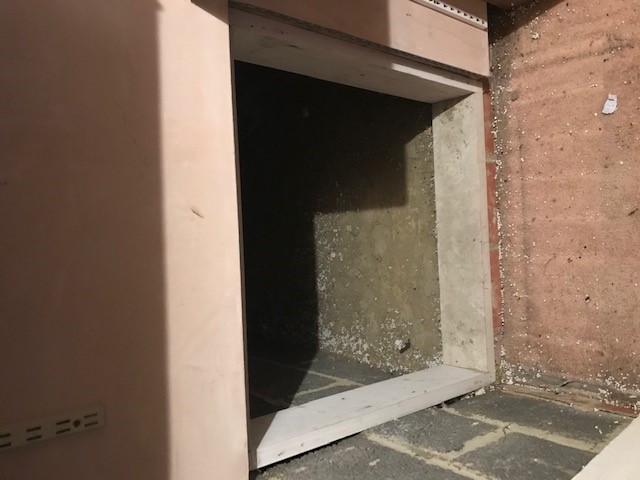

I have an asbestos sheet (well it looks like asbestos) that covers a square hole in the garage to house wall, which leads to a void under the staircase, and the concealed downstairs toilet cistern.
This panel now has a snapped off corner, and I probably need to replace it. If it's asbestos, and between the garage and house, I 'assume' its fireproof.
So I need some replacement board/material, that is fireproof.
Original is approx 1M x 1M x 11mm. There are many options on the internet, but as an amateur DIY’er, I wondered if anyone knew of such materals?
It needs to be removable for access, but sealed to remain 'vermin' free

If you send us a picture of that, I think it will be helpful to give you a proper suggestion.

by TimEwins » Mon Jul 27, 2020 12:25 pm
George441 wrote:If you send us a picture of that, I think it will be helpful to give you a proper suggestion.
Thanks - GG
Hi
Thanks for the interest.
I enclose some pics (I had to resize them from my phone)
I have found this material, which seem to do the job, but the minimum order is 5 sheets, and I only need 1.
https://www.fireboards.co.uk/
Distributors are a long way from me, but the manufacturer is about 45miles away, and will do me 1 sheet (apparently)
Tim
