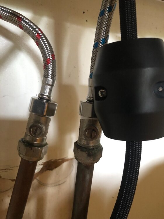

I attach some photos. The photos show:
- 1. How the previous tap worked. The flexible pipe screws directly onto the isolator valve.
This is how the previous tap worked.

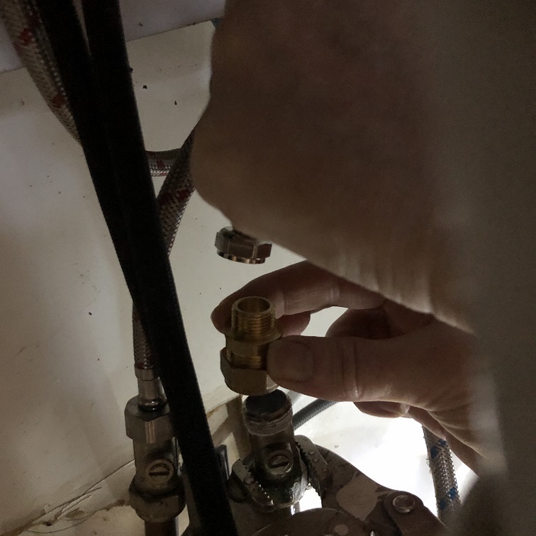

- 2. What I've been given. It doesn't solve my problem.
These are the parts I have.

Re: Can't find an adaptor to attach a flexible 15mm pipe to a threaded 5/8" isolator valve
by stoneyboy » Mon Jan 30, 2023 10:47 pm
Hi clareplumbing,
Easiest solution is to buy one 15mm isolating valve which will give you two nuts and olives. Find a friend who can supply you 2 pieces of 15mm tube about 75mm long and use these to join the old and new fittings.
