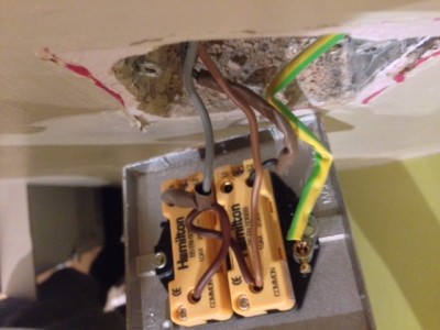

I'm looking for a bit of advice. I'm wanting to replace a two gang light switch (the second switch doesn't appear to operate anything) with a smart switch so that I can control its operation through Wifi or z-wave or whatever technology I choose.
One of the switches (left) currently operates 15 CFL bulbs built outside on our driveway.
The colour coding is what is confusing me. All the smart switches I've come across require a neutral line. Neutral to me is blue but googling around it could also be grey.
Attached are some screenshots of the switch and its wiring. Can someone explain the colour coding to me and what each mean? I assume one is live, switched live, Earth (yellow/green) etc.

In the UK we traditionally use the ceiling rose, both to support the cable to lamp and to work as a junction box. So in the main we do not take the neutral to the switch.
There was a move to use the switch as a junction box when installing low voltage lamps with a re-wire as the electronic transformers do not have the space in the cable box to take more than one cable. But this only happens with a rewire there are junction boxes made to replace the ceiling rose which in the more common method.
