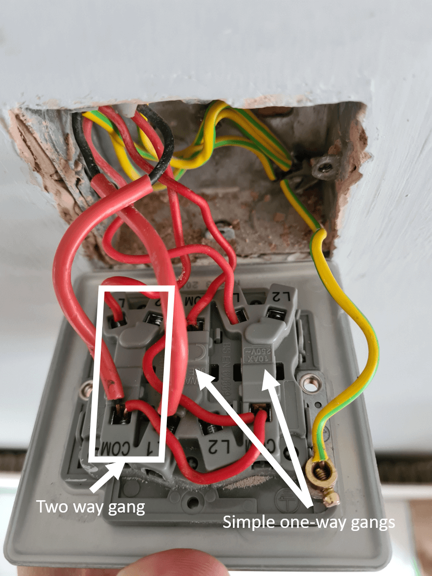

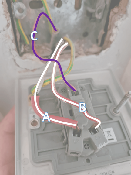

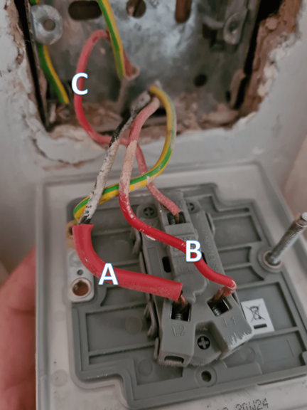

I have a hall light which is controlled from two switches, upstairs and downstairs. Everything works individually but the two-way is not behaving. When either upstairs and/or downstairs is on, the light is on, but it can only be turned off if both are off. Weirdly, if I hold the upstairs switch halfway between on and off, the light will turn off successfully, but apart from that there doesn't seem to be a way to turn off the light unless both are in the off position.
The upstairs light switch looks pretty simple and appears to be set up for a two-way switch:

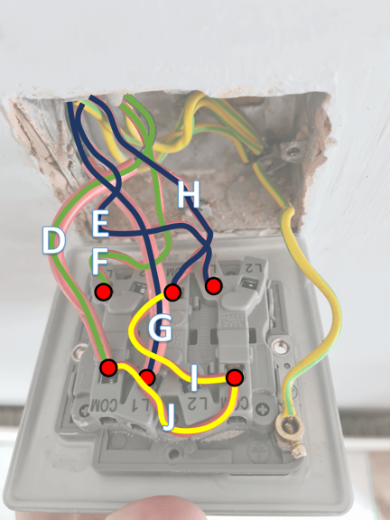

The downstairs is a three gang switch. The right two are one-way switches but the left switch should be two way and should be partnered with the upstairs light.
I think there are enough wires to make a proper two-way connection but my guess is that the "G" and "I" wires shouldn't go into the same port on the central gang.
I am struggling to figure out how to rearrange the wires to enable the two way switch to work properly. If anyone can help I would be really, really grateful.

Thank you very much for the quick reply. I'm struggling a bit with recognising which wires in your cartoon correspond to which in my photos. If anyone is able to identify them for me so that I know which to switch I would be really grateful.
By the way, I noticed an error in my original post. It should read:
"...but my guess is that the "H" and "I" wires shouldn't go into the same port on the central gang."
Biver wrote:I think there are enough wires to make a proper two-way connection but my guess is that the "G" and "I" wires shouldn't go into the same port on the central gang.

Without being there to test it, I would say that you should take the back wire that has red sleeving from the C terminal and connect it to the L2 terminal which currently has no wire at all.
Leave the other red wire in the C terminal.

This worked! Thank you very much, Mr White
