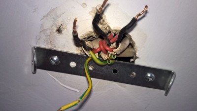

I am trying to replace a ceiling light fitting and I have just taken down the old fitting and now I am unsure how to wire up the new fitting!
The wires coming out from the ceiling are yellow/green (earth) then three black wires, each of them have a red wire attached and also a yellow/green wire looped across. I am a complete novice, but have done some simple wiring successfully and do understand that the light switch is obviously connected across other light switches downstairs (as these are now not working as my light fitting hasn't been wired up!) I also understand that one of the wires is a S/L (Switch live) but unsure which one. The light fitting I am trying to connect has an earth (yellow/green) wire and also a brown (live) and also a blue wire (neutral).
Can someone please tell me how to wire this correctly?

You need to find which wire is the switch wire, you then connect the other two blacks together and connect your light across the switch wire (single black) and the neutral (two blacks)
You will need a multi meter to find out which is the switch wire.

Just to add to Mr White s Advice , , you would make that the mains is isolated before you use your multimeter on omhs/continuity scales.
