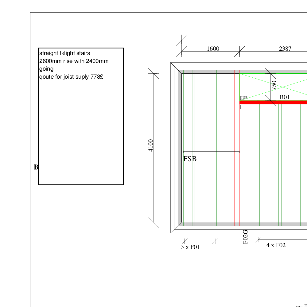

examples of metal web joists. best using quick stage scaffolding much safer than ladder used these in loft conversion they are se approx. 150mm above existing roof from eaves to eaves can easily reach upto 8 metre span @ 600mm simple 1 man op
