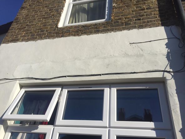

Sorry, yes just the window recess. Here are some pictures.
On the internal picture you can probably see a small discoloured patch and small crack in paintwork above the window, this is where the drip was coming from.
On the external picture, you can see the wall is vertical above the window, so nowhere for water to pool - my suspected culprit is the top of the render not being fully bonded to the brickwork. But I may be totally wrong!

The reason you have with water ingress at this point will be difficult to identify. Water running down the brickwork and getting behind the rendering leading to saturated brickwork may be a cause but with a south facing wall and porous bricks it is unlikely.
It is possible that rainwater running down the rendered part could then travel in to the top of the window and by capillary action soak the bottom part of the wall. Suggest you try running a bead of silicone across the top of the frame to seal the render to the frame.
Whatever you do it may take months/years to establish if it has been successful.
