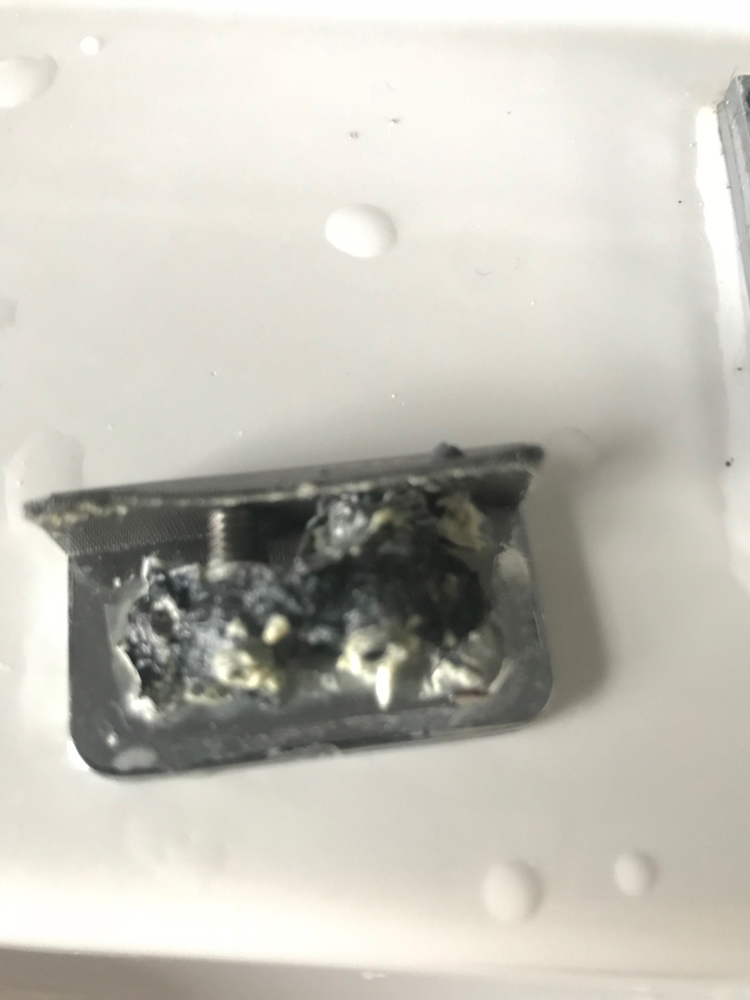

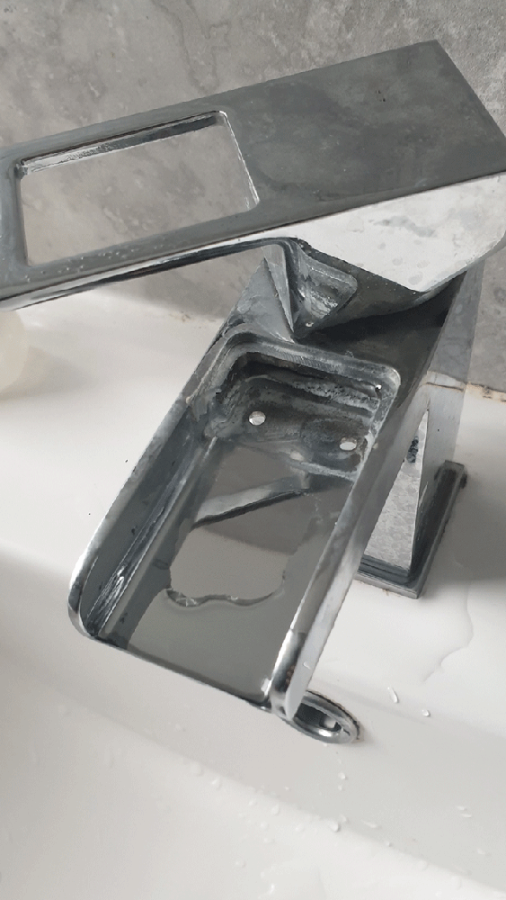

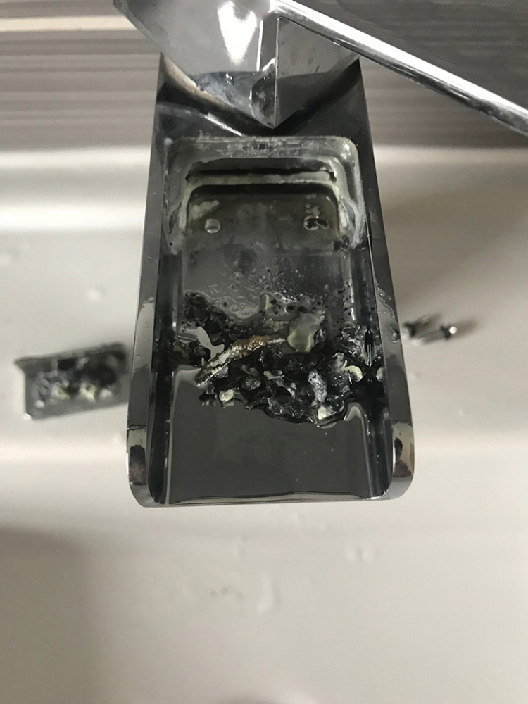

I pulled the top plate off the tap spout which was easy enough as I assumed it would now the screws were out. To my surprise it was full of metal piece, like really full!
I thought this may of been some kind of metal build up from the water, but I further inspection it was the underside of the plate which had corroded away. The screws could not tighten back up as they were just crunching through corroded metal.
So, I'm not left with a tap which works but no top plate. The two screws had washers on so i've dropped them back in he hole from the top to cover the holes for now... works fine like that, but unbeleivably it needs a new tap!
Waterfall tap, top plate removed
Watefall tap, underneath the top plate

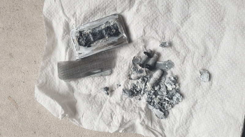

I have the exact same problems.
When I informed the manufacturer (kartell uk) about it they won't honour the warranty and basically said its my fault for taking the screws out.
So much for lifetime garantee.
see pictures below.
I will probably glue couple of plastic caps in the holes to stop the water from dripping.
