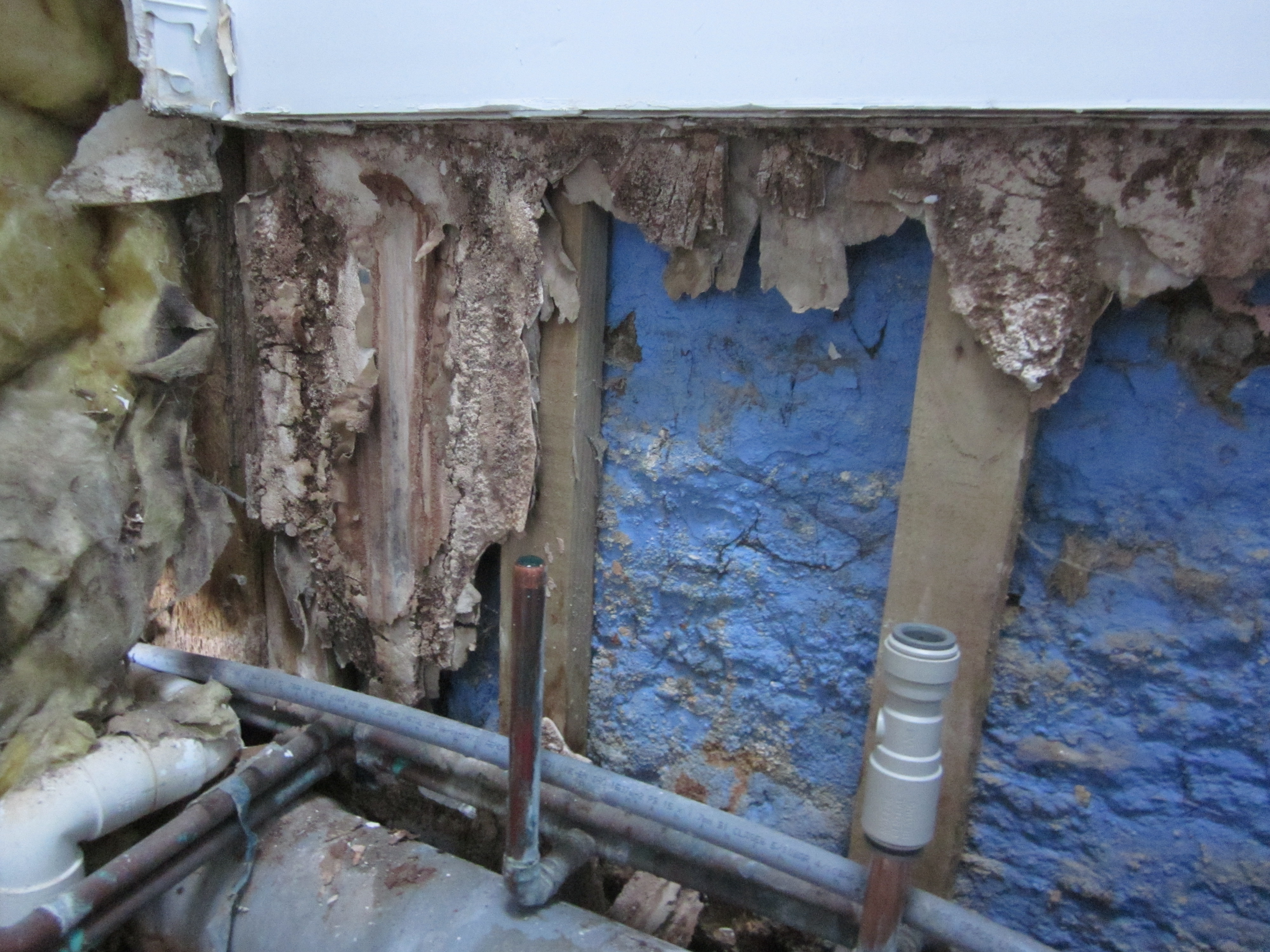

Funnily enough we are presenting exactly this at the Home Building and Renovation show at Sandown Prk, Esher, this weekend and the image below shows an example of what can happen if the tiles are sealed to the bath and water gets in behind them.....The damage shown is a result of an undetected faulty tile joint just under the shower head which remained undetected for 12 years !!
