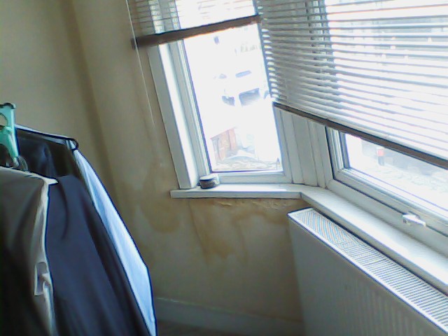

Do you think this is a serious problem, it looks like the plaster is peeling off...should i just pull it all off and replaster it?
Pictures of damp wall

Hi cupoftea,
Looks like you have water penetration under the window, until you’ve corrected this problem there is little point in replastering.
