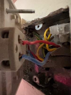

Hi Team
Shelly or a SONOFF WiFi Touch Wall to run with Alexa
Im lost on the "Neutral wire required "
Pic of the switch, its a 2 gang
Im good with a screw driver, just need a clue, :)
Thank you

"No neutral" means the device does not require a neutral to work.
99% of things require a neutral, except switches.
You may have a bigger problem.
The switch you pictured, operates a light, does this light have another switch to operate it?
Typical example, landing light, One switch downstairs, another switch upstairs. (If so, it is 2 way, not 2 gang)
All is not lost, you could change the lamp to one of these Click me and change just the lamp

It seems you can use some smart switches as two way, but not hard wired as two way, the second switch just has line and neutral and you set it up with the app.
But in the main I have gone for smart bulbs.

Yes the switch in the photo has another switch (2 Gang?)
It turns on 4 led G10 lights
The idea is to use Alexa to turn on those lights
Thank you for the replies,

The switch you have is 2 way
I am not aware of any "smart switch" that operates as 2 way with an existing 2 way switch.
2 way switches do NOT require a neutral, so if you were to "bypass" the switch with a smart switch/shelly unit, it still would not work.
There are some "smart switches" that do not require a neutral, but these have been known to be problematic.
You do however have a couple of options:
1) Change the light fitting to a batten holder, and fit a smart lamp, after all, it is the light you want, not the fitting.
2) Have the light switch re wired (Lots of mess) to add a neutral.
3) Buy some table lights and put smart lamps in them.
Most folk use a combination of options 1 & 3
