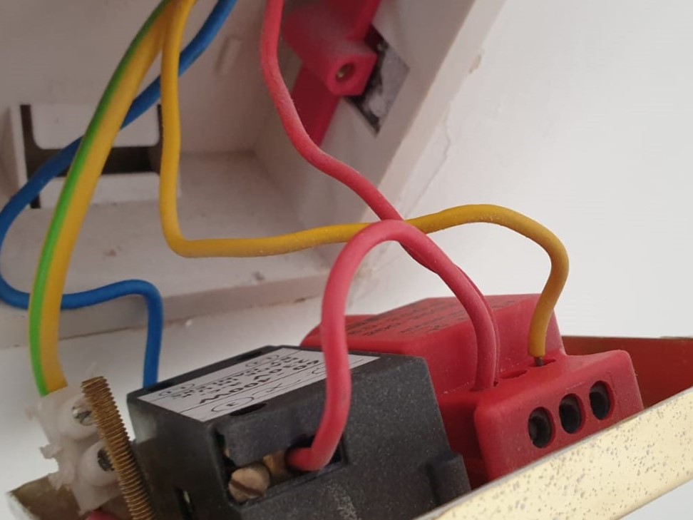

Hello
I have a dimmer switch with two controls each controlling different set of lights. L1 in each is connected with blue and yellow. Red is connected to one Com and another wire connects both Com.

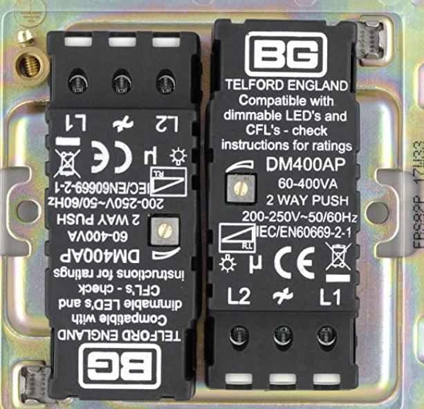

I have a new switch
Wanted to check if I follow similar patter do I have to connect both coms?

Yes I agree not good markings, but Com is marked with AC sign with arrow through it, so line in to Centre Com and Line out from L1, or L2 swapping L1 and L2 changes which way is off and which is on.
Since red is linked one would assume red to centre.

Thank you for posting your response. I am not getting any like-for-like, it is years old I think.
To summarise:
Yellow & Blue connected to separate L1 (two different blocks)
Red connected to the arrow and there is a link.
May be the new image can give bit more detail.
When I follow the same pattern in the new switch, one set of lights always on. Not sure why
Yellow and Blue connected to L1
Red to Com and a link
Thank you for the help.

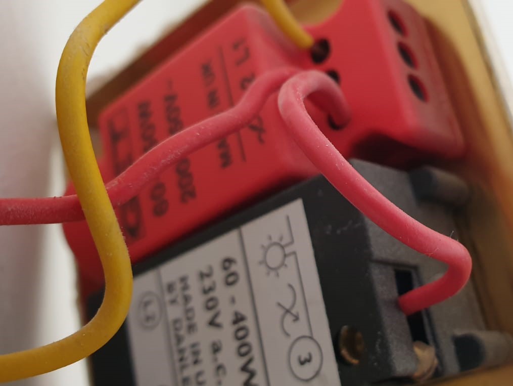

Attaching image with red wire

If it helps, your new switch is the same as the old switch, but it is two switches, one is upside down in relation to the other, a lot of folk get it wrong because of this.
