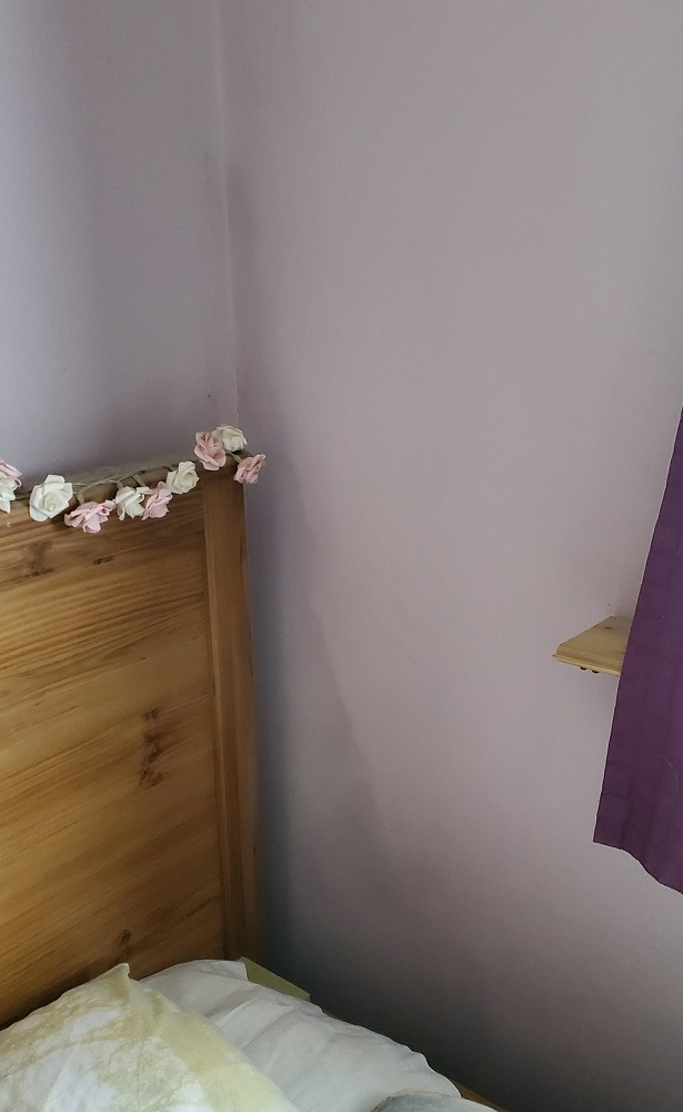

Hi, I would really appreciate a little bit of advice regarding (what I believe) to be penetrating damp in the corner of my first floor bedroom (on the adjoining wall to the neighbor's Terrace house).
Mostly because someone has already come out to "fix" it and it has gotten worse so would appreciate some advice before I contact the next person.
UK based. These are terrace house from the 1920s - single brick, no cavity wall for insulation etc.
House next door was derelict for the first 9 years of me living here and there was never any issues, so I don't know if that's related (the builders had to gut the whole house).
The damp patch started in the inside bottom corner (front adjoining wall) and has spread out from there (up the corner in a pyramid shape).
It feels cold/damp, but is not wet/dripping. There is no mould on it.
There is no damp/leak in the room below or the loft/roof, or elsewhere in the room.
The gutter down-pipe is about 3 Qtrs of a foot away from this issue corner.

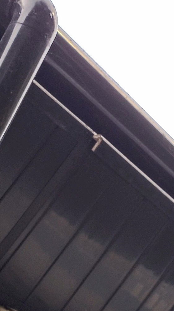

I had noticed that the neighbors sofit was hanging down directly above that corner with the issue. Had thought maybe water was getting trapped/was dripping and was perhaps hitting the outside wall further down causing the damp issue.
My neighbour got her window cleaner who does odd jobs to have a look and he said my neighbours fascia/sofit was a bigger size than mine and hence hung down. He "fixed" it by filling it with a sealant.

I have attached photos of the damp patch in the bedroom and also the front of the house. Have circled the area that the damp started to appear internally. Lastly a picture of the neighbours sofia hanging down (before it was sealed) - in case this maybe could be causing the issue and perhaps since being sealed is directing or leaking water elsewhere.
Any advice, input, guidance is very much welcomed. Just not sure where to start, having already had someone out that claimed to have fixed the issue.

Because of the shape and location of the damp I would suggest it it coming from outside. Get the downpipe dog leg checked to see if it is clear - when it is raining you may be able to see if water is coming out of the drainpipe which would indicate a blocked downpipe. You should also get the rendering checked for hairline cracks in the area you have highlighted, especially the join between your render and next doors,

It is not possible to tell from your pics whether the downpipe has an open end or just goes into the ground. If the latter it may be blocked and may be a source of water running down the wall at a higher level.
