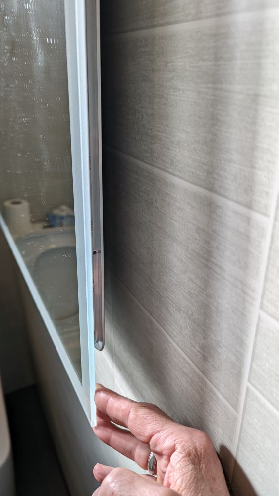

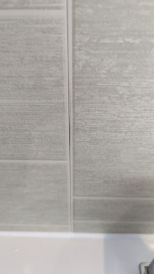

panelled wall and then installed shower tray on platform, so only sealed round edge, i thought you sealed then brought the panels down to meet shower and second sealed?

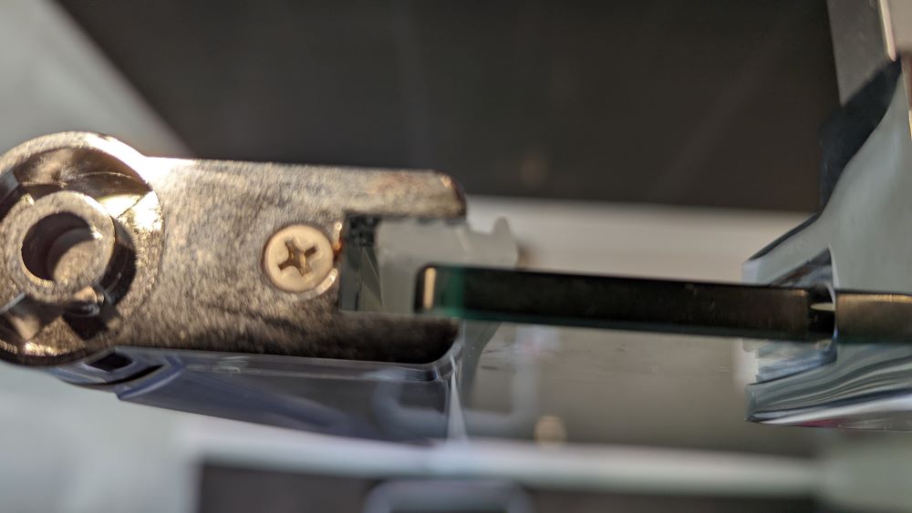

flipper barely held on

gaps in wetwall panels

You certainly have grounds to complain about the split shower tray and gappy wall panels. Unfortunately contractors who carry out works to such a poor standard are reluctant to put things right. If you are going to persue your contractor you will need to get a written report - perhaps ask your local water board if they can suggest someone.
