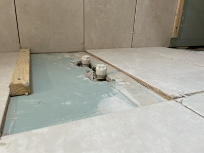

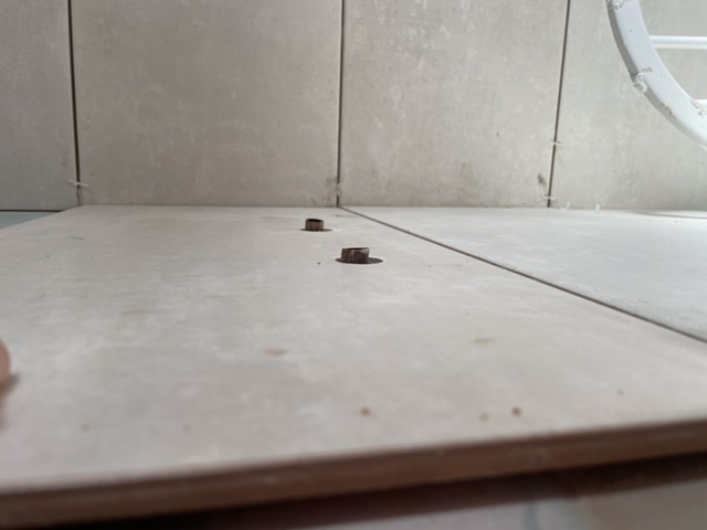

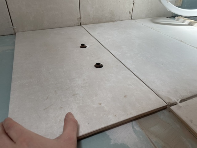

Hi, I made a decision to fit a new suite and re-tile my bathroom- no moving of pipes or anything too complex!
however my shower pipes for a mixer shower are too short - they only protrude from the tile around 10-15mm and i think they need to be 30-40mm
any advice on extending this, preferably without soldering! and if this needs to be a professional plumber would this be an expensive job?

Hi mannion13,
Many shower valves come with chrome cranked adaptors which will do what you want.
