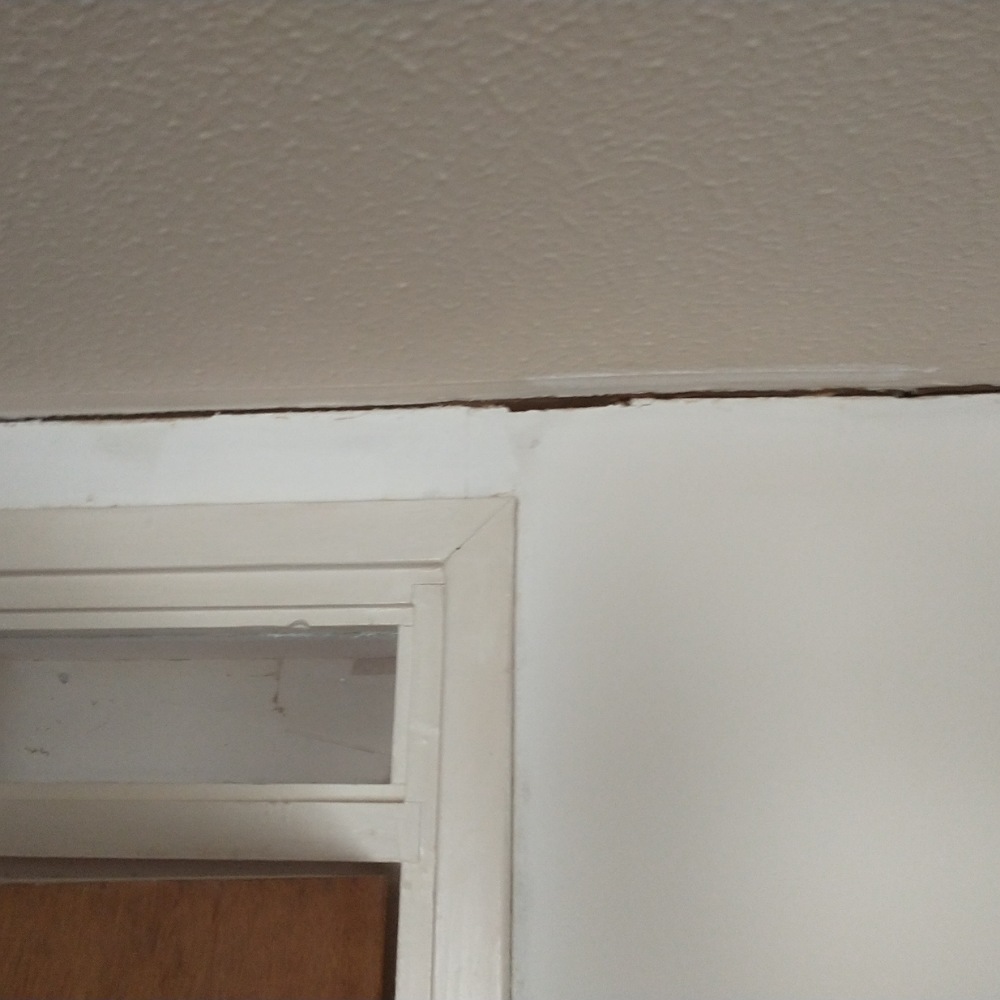

In a couple of bedrooms upstairs there is large gaps between the Plasterboard walls and the ceiling (see pictures).
From what I can find on the internet I think this problem might be associated with something called 'Truss uplift'.
Has anyone had any experience with this and any advice on how to fill it?
Any tips welcome.
Thanks,
W

It looks like scrim has not been used when the plastering was done, probably the easiest solution would be to fit coving.
