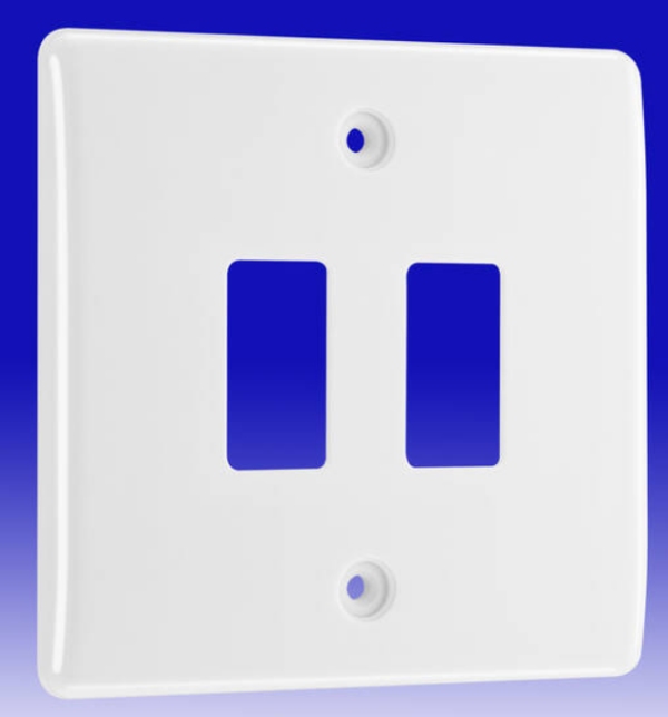

Above is an example of a 2 gang cover.
If you can't find one, change the whole switch

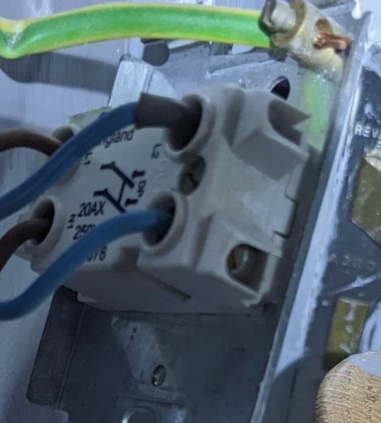

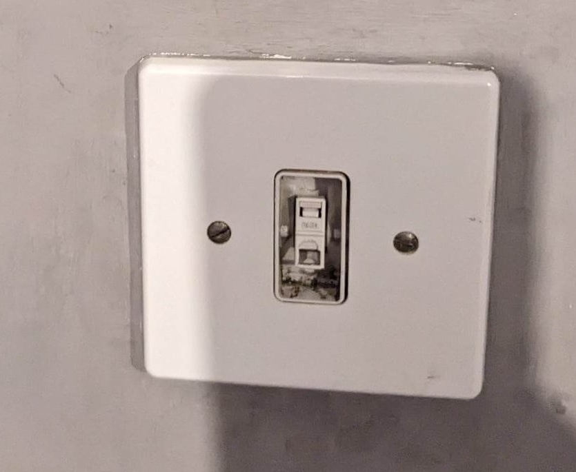

I don't think I've made it clear what the switch is actually doing in my question so I've included some pictures. It's a one-gang switch not two-gang and it switches on two LED spotlights. I've asked in both b&q and screwfix and been told that these switches aren't available to buy any more as regulations have changed so I'm looking for a way to replace it. I did try wiring both blue wires into one port and both brown wires into the other port but somehow this caused the light to come on when the light switch for the other bathroom in my flat was turned on as well, so there is some connection between the two circuits. Is it going to be possible to replace this without an electrician?
This is how the switch is wired. I believe this type of switch doesn't exist any more to buy.
This is the switch as it currently is - it's a single switch that powers two LEDs. It's only one-gang

The staff at the likes of Screwfix and B & Q (Same parent company) are NOT electricians, they are giving you incorrect information. That said, I suggest that in this case you get an electrician to do the job for you.
