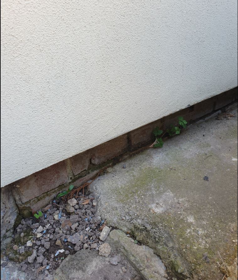

See the attached photos of the damp patch in my kitchen outer wall, this adjoins my bathroom (yes, it is a downstairs bathroom), and the back door and kitchen.

Outside, we recently removed some of the patio which had been fitted 10 years ago (it was located right up to the rendering on the outside wall), because we were told it could have breached the existing damp course.

This is the outside wall,where part of the patio was recently removed

It looks like your patio is level with the DPC - if you have similar damp ingress along the whole of the wall then you will have to form a mini trench where the patio meets the house wall. It will be some time before drying out occurs.
