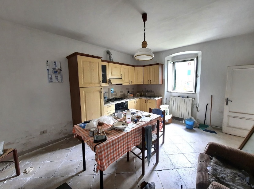

Hello,
I have to relocate for work abroad and trying to arrange viewings of properties in a foreign country with a language barrier.

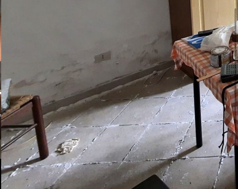

There appears to be some peeling paint on the base of the wall with potentially salt/lifting grout between the tiles.
Is this raising damp?
The listing describes the property as structurally sound but neglected for some years.
Thanks!
Posts: 6552
Re: Raising damp?
by stoneyboy » Thu Jun 06, 2024 11:11 pm
Hi sam1234,

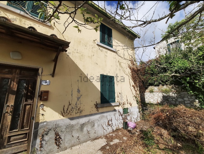

Almost certainly rising damp which may have been worsened due to the rendering which has been applied outside.
