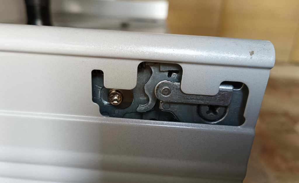

Thanks for the reply - only just had a chance to get back to this.
I am not getting any further. I have attached a photo (hopefully). There are two screws/bolts in there. The one on the left moves the internal mechanism up and down a few millimeters. The one on the right does not seem to do anything; it does not even seem to be going in and out.
I have tried on the other side too, as per suggestion, but has not ejected the mechanism.

Hi f2andy,
The one on the right adjusts the drawer side to side - use a large cross head so you can lift the horizontal lever above it. On the side that is still attached you can try pulling the drawer front outwards while you lift the lever.
