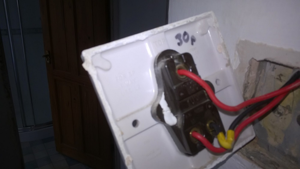

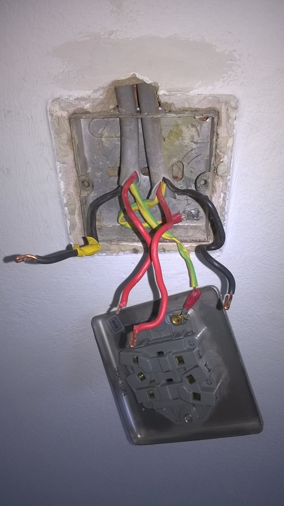

Can confirm the two reds are live not the two blacks. The first two images are the downstairs hall 2 gang switch and the third image is the upstairs 1 gang hallway light switch.
When I took the old plastic switch off a small wire if I recall was connecting the two Comms...

No my error of having them too close together when testing. Only the red wire on the left is live

Please confirm by left, do you mean the red that is part of the set, that has the black with the yellow sleeve on.
If so this a little confusing as the landing switch seems to suggest they match up. Do you have a proper test meter, that can test voltage and continuity, this would be a two pole/probe tester.

by boefie1976 » Tue Aug 08, 2017 7:58 pm
Yes left is associated with the black with the tape on. I am using a Schneider Voltage tester IMT23009

OK, lets try this.
Red that is perm live to com of one of the gangs, then put the black with yellow tape/sleeve into L1 of same gang and see if this works your hallway light.
Leave other cables disconnected but put them in separate connectors, just to be safe.
If that is success, then you can link across with red link to com of second gang, then copy L1 and L2 with spare red and black in second gang.
Do not forget to safely isolate and connect the earths, but you do need to confirm the earth path a non-contact pen will not do that. You need a two pole instrument, without this you could be putting yourself and other house residents at risk.

by boefie1976 » Wed Aug 09, 2017 7:53 pm
Worked perfectly, mush appreciated Thank you.
